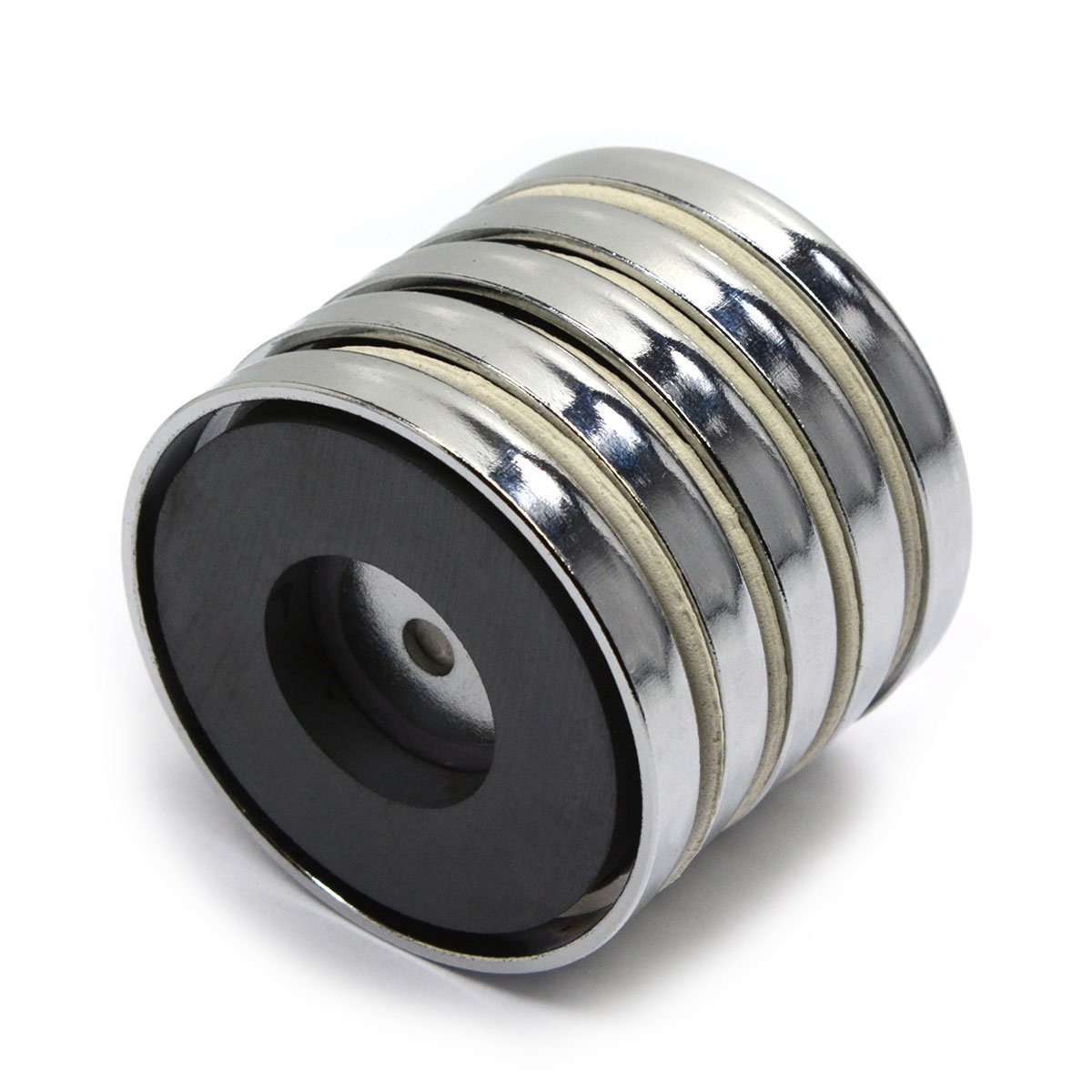

|| -NYCCNC IFTTT AIR COMPRESSOR CONDENSATION VALVE CONTROL
|| -version 1.0
|| -author Ed Rees
|| -www.nyccnc.com
|| -1/25/2018
|| This program is free software: you can redistribute it and/or modify
|| it under the terms of the GNU General Public License as published by
|| the Free Software Foundation, either version 3 of the License, or
|| (at your option) any later version.
|| This program is distributed in the hope that it will be useful,
|| but WITHOUT ANY WARRANTY; without even the implied warranty of
|| MERCHANTABILITY or FITNESS FOR A PARTICULAR PURPOSE. See the
|| GNU General Public License for more details.
||You should have received a copy of the GNU General Public License
||along with this program. If not, see <http://www.gnu.org/licenses/>.
const int hourTest = 4; // switch to manually activate condensation drain cycle.
const int onPin = A0; // photoresistor to sense the shop's lights.
const int valve = 7; // controls air valve via power switch tail.
const int flowMeterPin = 6; // data pin for hall effect flow meter.
const int flowMeterInterrupt = flowMeterPin;
int attempt = 0; // records condensation valve cycle attempts
int valveTime = 5000; // time valve is kept open (ms).
int meterPulseCount; // counts pulses from hall effect flow meter.
int meterPulseThreshold = 1000; // flow meter pulse count success threshold.
int onSensorValue = 0; // photoresistor initial value.
int onSensorThreshold = 1500; // photoresistor on / off threshold value.
bool shopOpen = false; // are the lights on?
bool hour = false; // hourly valve cycle trigger. Controlled via IFTTT date & time trigger AND manual trigger button.
bool error = false; // detects valve error via flow meter.
void setup()
Serial.begin(9600); // begin serial communication @ 9600bps for debugging.
pinMode(hourTest, INPUT);
pinMode(flowMeterPin, INPUT);
pinMode(valve, OUTPUT);
digitalWrite(flowMeterPin, HIGH);
digitalWrite(valve, LOW);
attachInterrupt(flowMeterInterrupt, meterPulseCounter, FALLING); // interrupts to record flow meter (hall effect sensor) pulses on falling edge.
Particle.function("hourTimer", hourTimer); // creates a Particle function that can listen to IFTTT triggers.
meterPulseCount = 0;
void loop()
if (digitalRead(hourTest) == HIGH) // manual trigger for condensation drain cycle.
hour = true;
onSensorValue = analogRead(onPin); // set sensor value equal to current photoresistor value.
if (onSensorValue > onSensorThreshold) // if sensor value is above threshold, shop is open.
shopOpen = true;
Serial.println("SHOP OPEN");
else // if sensor value is above threshold, shop is closed.
shopOpen = false;
Serial.println("SHOP CLOSED");
if (shopOpen == true && hour == true)
Serial.println("MAKING ATTEMPT...");
Serial.println(attempt);
digitalWrite(valve, HIGH); // open condensation drain valve
Serial.println("VALVE OPEN...");
delay(valveTime); // delay for time specified by "valveTime"
digitalWrite(valve, LOW); // close condensation drain valve
Serial.println("VALVE CLOSED.");
delay(2000);
if (meterPulseCount > meterPulseThreshold) // has flow meter detected airflow?
Serial.println("SUCCESS!");
Particle.publish("Valve", "success"); // trigger IFTTT event. NOTE: case sensitive!!!
error = false; // no error
attempt = 0;
hour = false; // set hour to false so no further attemts will be made this cycle.
delay(2000);
if (meterPulseCount < meterPulseThreshold) // has flow meter detected no airflow?
error = true; // error.
attempt++; // increment attempt counter.
if (error == true && attempt == 1) // on first attempt after error...
Serial.println("FIRST ATTEMPT FAILED, MAKING SECOND ATTEMPT.");
error = false;
delay(2000);
if (error == true && attempt == 2) // on second attempt after error...
Serial.println("SECOND ATTEMPT FAILED - TEXT ALERT.");
error = false;
attempt = 0; // reset attempt counter
Particle.publish("Valve", "airError"); // trigger IFTTT event. NOTE: case sensitive!!!
delay(2000);
int hourTimer(String command) // Particle function for hourly trigger. NOTE: case sensitive!!!
if (command == "hour")
hour = true;
return 1;
void meterPulseCounter() // Insterrupt Service Routine
meterPulseCount++; // Increment the pulse counter
