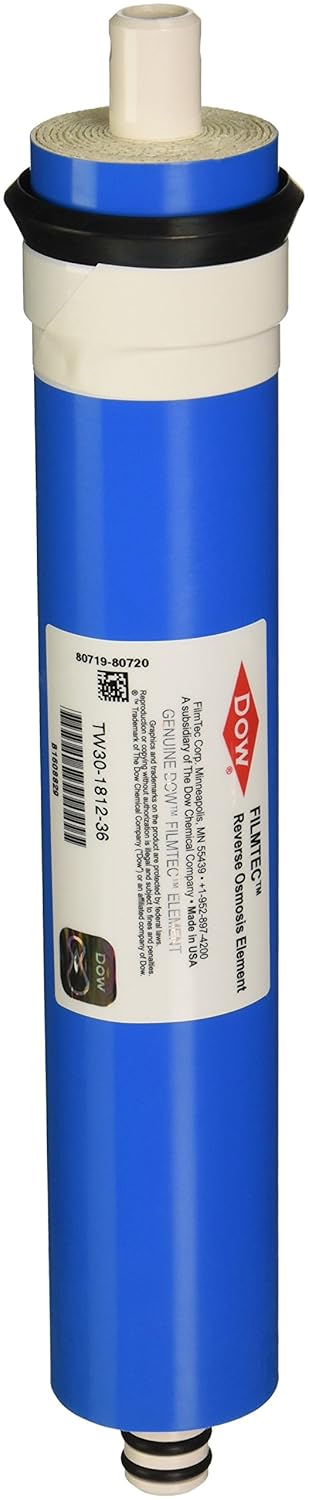

Replacement Membrane

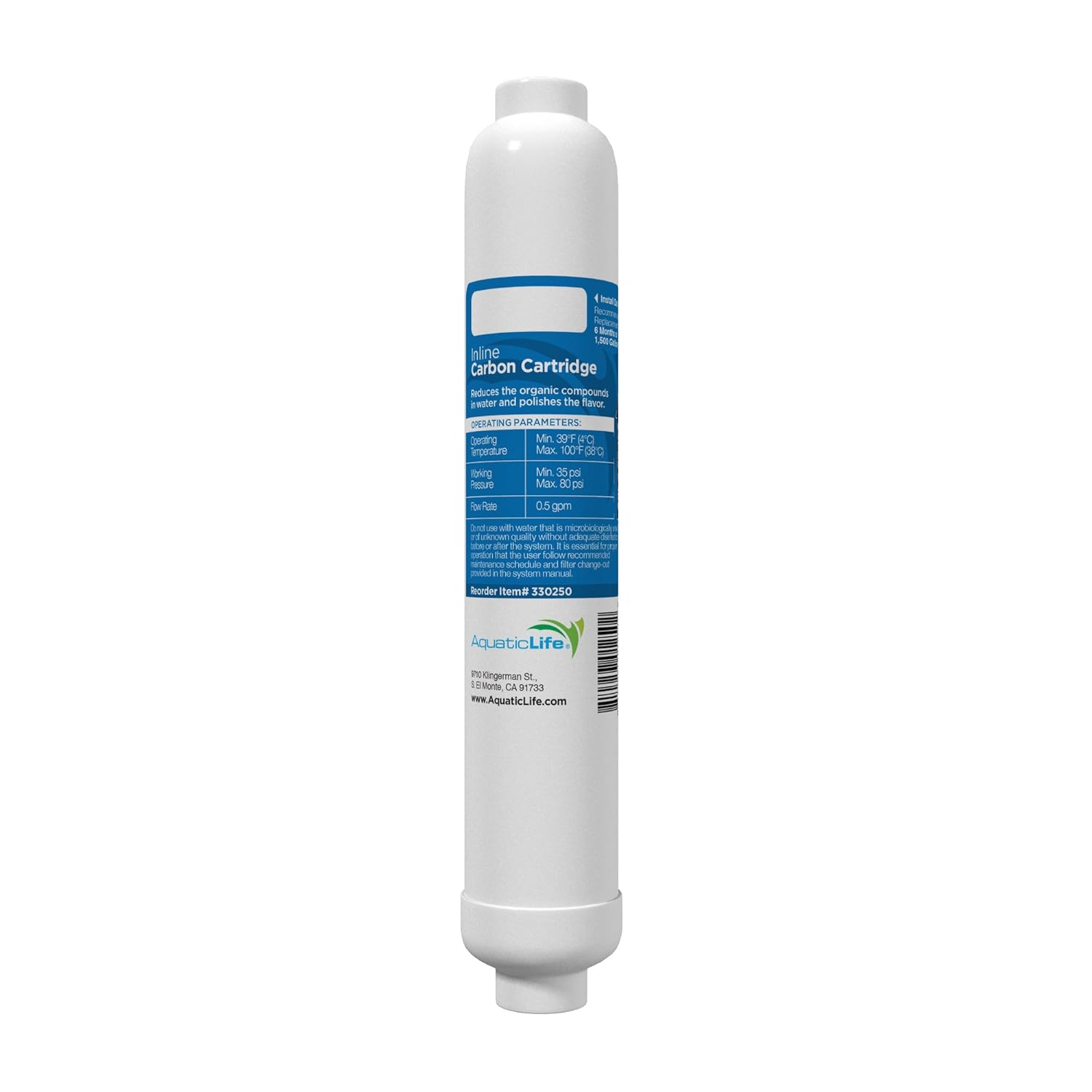

Replacement Carbon Cartridge

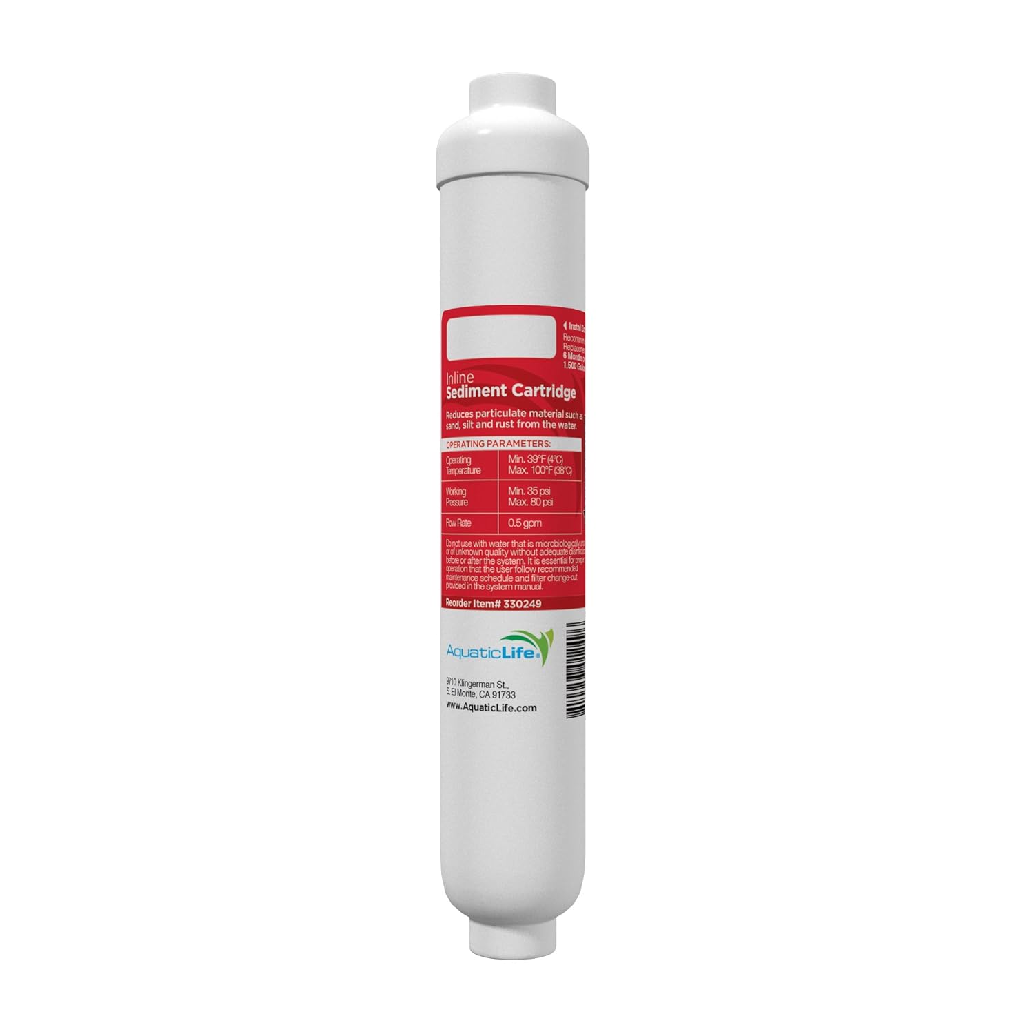

Replacement Sediment Cartridge

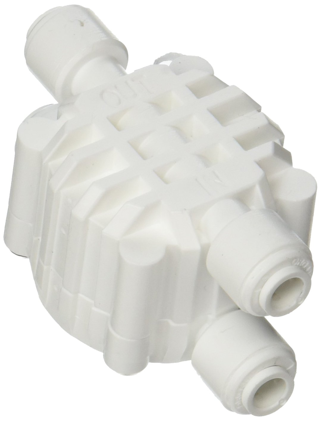

Auto Shutoff Valve
