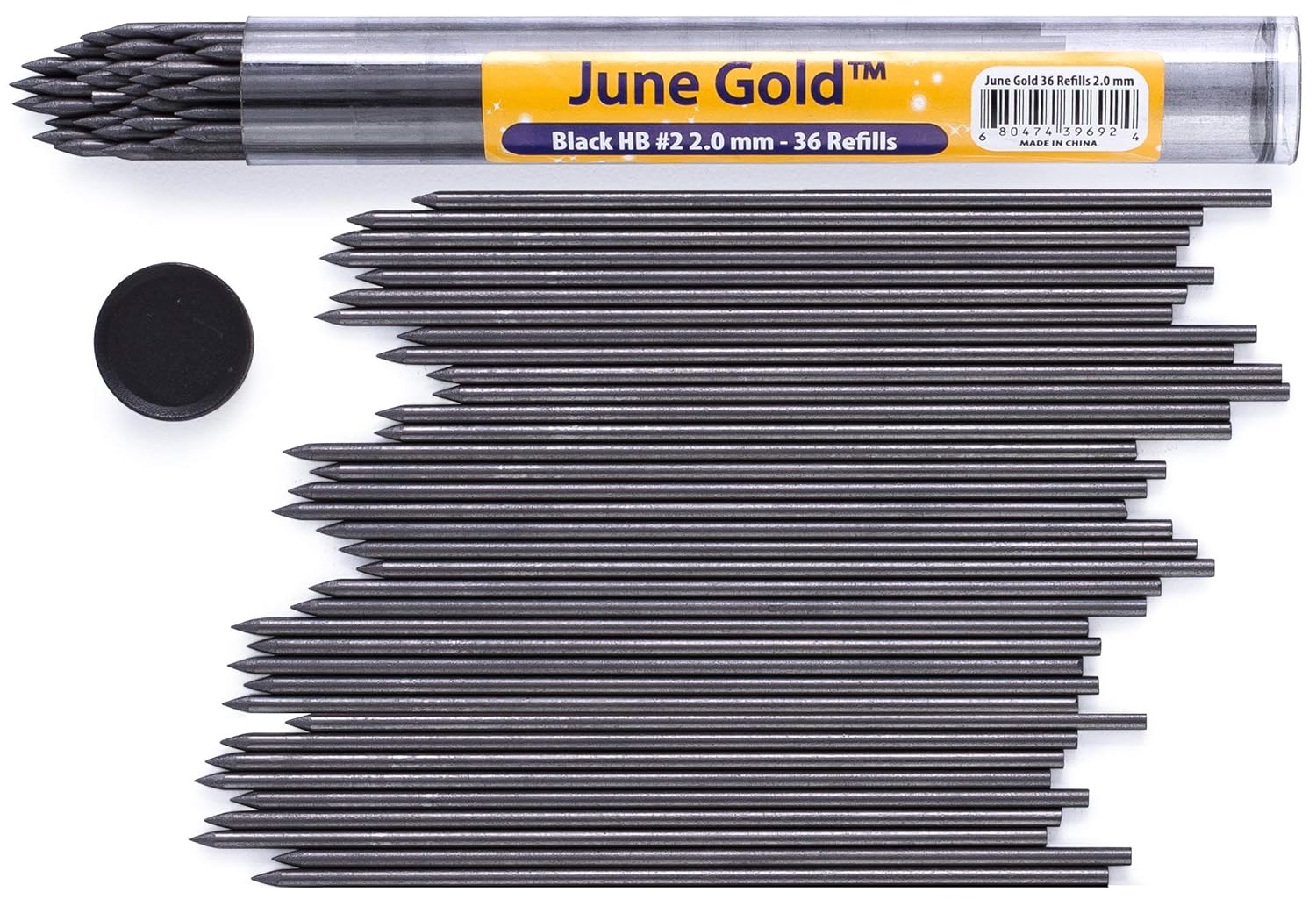

DIY Haimer Probe Tips (CHEAP)!
Haimer probe tips can get expensive! We wanted to bring you a cheaper, equally as functional alternative, in addition to having something we can use for our Tormach training classes. DIY probe tips can be tricky, but we have a solution that is both inexpensive and accurate!
Bill of Materials:
2mm Pencil Lead
Loctite 380 BlackMax
3D Printed Phaimer Tip
See below for details on 3D printing this part
